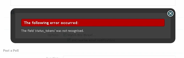

One of our members is having the following error when posting on a specific forum:
The field 'status_tokens' was not recognized.
Any idea on why?

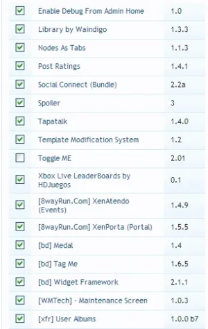

It might be related to [8wayrun]Xenatendo because i have that forum selected as an event forum... I as a superadmin can post events or post a new thread, however another person that i have as an administrator can only post events (to the calendar) but not a new thread in the events forum.
Can you post the exact error? It's pretty difficult to guess which add-on is causing it without the full Stack Trace error. Should be in Tools > Server Error Log.

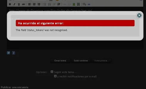

Theres a problem too on my setup.
after i use xf 1.1.4 and upgraded to socialconnect 2.2b
this is the error:
Then i disable Socialconnect and i can post.
but if i enable socialconnect back, it wont post and it gives the above error
Contact the add-on developer.
offtopic, welcome back brogan!
Here's the fix. Replace library/SocialConnect/DataWriter/Discussion/Thread.php with the attached file.
