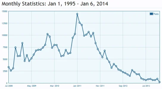

A couple of my forums have seen a HUGE drop in engagement, primarily post counts... it's making me very :(
I'm trying to analyze as much data as possible to determine if it's the "head" or "longtail" users that have dropped off, and why.
One thing I thought to do was to run a report of the top 20 members who were posting during the big moths and compare that to the top 20 members posting during the smaller months. Did all my members stop posting, or did I just have a handful of main members that were posting thousands of times but then stopped?

Did this correlate with your conversion or had there been a decline already? Looks like this dates back a long way...
Totally independent of the conversions... which are only a few months old. Those declines, especially on that site started years ago. Drops have happened on 3 of my sites. Part of the attribution is:
  1. Huge drama / fall out between members (want to use the query above to isolate specifically who and when) that left and went to other sites, specifically FaceBook.
  2. Got hit by an algo change (Hummingbird) in August.
I'm seeing some comeback post-conversion, but still a LONG ways to go to get to early 2011 levels.
I'm seeing a slight uptick in posts, but I've still got a VERY long way to go. I'd love to really isolate which users accounted for the posts during those months (using the first query) and then run a query on their monthly post counts (second query).
