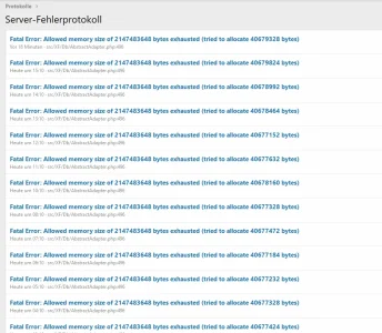

I noticed the error where users activated the CronJob. PHP was at the limit. I had to adjust in PHP. Then the database error came :(
I now have a lot of mistakes again. I do not start a cron job manually. It's still the hourly cleaning. I set the PHP memory limit to 2048M.
    ErrorException: Fatal Error: Allowed memory size of 2147483648 bytes exhausted (tried to allocate 40679328 bytes) src/XF/Db/AbstractAdapter.php:496
