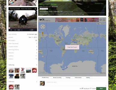

Can somebody please tell me what I'm doing wrong here? The SPOT embed works fine but I can't seem to make it work inside of the <xen:if> tags or maybe it's the {$message.customFields.spottracker} that isn't working inside the SPOT script the way I have it.
I created a custom user field called spottracker and I created a template called spottracker and put this in it:
Here's what this looks like when you take out the <xen:if is="{$message.customFields.spottracker}">
I dont have a live SPOT tracking feed to test with right now but I'm pretty sure this should work no matter what I put in the custom field. I've seen SPOT widgets all over the internet with "FEED NOT FOUND" so it should still work.
