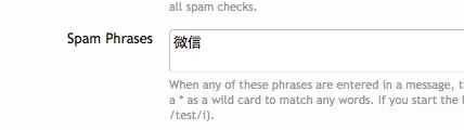

rebelde
I tried to block 微信 in the Spam Phrases, but I couldn't get it to block the posts.
The work-around is to make it a regular expression:
/微信/u

Each spam phrase that isn't already a regex is normalised into one, e.g. the regex that runs on that example above is:
#(?<=\W|^)(微信)(?=\W|$)#iu
Note the unicode modifer at the end.

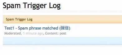

Yes, using the same user with 6 posts (my limit is 10), I edit a post.
If it has 微信, it does not match - edit allowed
If it is /微信/u it matches and blocks - edit blocked.
I change it back and forth, over and over and get the same results.

If you block "test", it won't match "test2" as it looks for non-word characters afterwards. In CJK languages this is potentially problematic, but I'm not aware of a definitive way to have it work as expected in both cases.

You don't actually have to use a regex -- simply using * around the words is sufficient. The system is basically the same as censoring in this regard (in terms of word detection).
Based on this, I don't think anything is going to explicitly be changed here. I believe this is the only time we've actually had a question surrounding this (regarding CJK) in either censoring or spam prevention.
