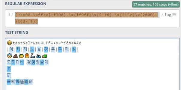

OK, this bit of regex craziness seems to let emoji and some other common symbols pass, but grabs other characters which may indicate spam:
/[^\x00-\xff\x{1f300}-\x{1f9ff}\x{2116}-\x{215e}\x{2600}-\x{27ff}]/ui
This site is great for testing regex:
(When testing with a lot of different characters, make your suffix /uig to catch all instances, not just the first one. But in XF's spam filter, you'll likely want /ui.)
