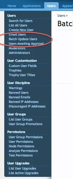

Thanks for all that info. I'm nearly there. Except for step 3. How do I mass update all my users to the Validated Users group (and does it have to be as 'secondary group', or can it be the main group?) - do I need a new add-on for that?
There is a batch update users built-in XenForo 1.2
I would not recommend it to be primary
I specifically put that example in the manual: http://xenforo.com/help/user-group-promotions/
