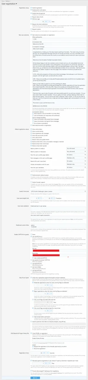

Hi guys, I have a few issues with spam accounts that I was wondering if I could get some feedback on.
We've had a lot of spam accounts being created constantly and have mostly solved the issue.

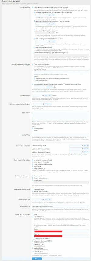

We have the following settings:
Link to images here:

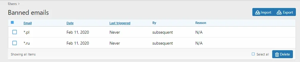

User registration
Spam management
Banned emails
However, we are still receiving about 5 or so accounts a day who are somehow not only registering, but getting their accounts approved.

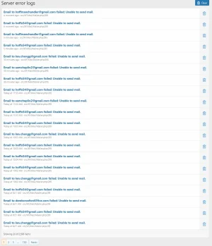

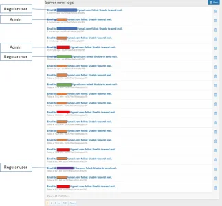

Additionally, we have a ton of "Unable to send mail" notices in the Server error logs

Thanks. I had seen this suggested a few times and was thinking of picking it up.
Did you see anything wrong with my settings? Wanted to also make sure I wasn't messing with something there as I'm not sure how accounts are being approved without me doing it manually.
It's hard to read the screenshots as we do some resizing, but if you have manual approval enabled and accounts appear to be bypassing that, the first thing to check would be add-ons as the only time we've had reports of that, it's tracked by to an add-on. As an example, in the past, I believe Tapatalk has caused related issues because I think they have their own system for registering users.
Mail sending is probably unrelated, though the bit you quoted from your host might be the cause of that. However, it looks like the emails they listed there aren't generated by XF (they appear to be coming from your wiki). In terms of debugging why mails aren't being sent, that would have to be found in the mail logs on the server which is likely something your host would have to check.

Weird, here they are:
If you want ALL accounts to have to be manually approved, that's in the usergroup perms.
I meant that bots are somehow able to create an account and have it approved by bypassing the need for me to go into the queue and approve/deny their accounts. (The little moderator approval queue in the top left corner)

Sorry! Here is a link to the images in a more legible format:
Let me know if you see anything wrong with my settings.
