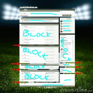

Ive seen some nice sites that have spaced up the layout into blocks with the background picture being seen through the spaces. How do I do that? XenPorta? Isnt that a huge addon with a lot of stuff I dont need?
Please tell me how I should do that. Ill attach a blurry picture of how I mean. Look at how the background is being seen between blocks. Thanks. :love:
Yep looks like they just made the background a full image, then removed like the background for like pagecontent or along those lines
Hey guys!
Yes it is just one big background image, but how do I separate my content into blocks like that? See my new picture, I want to cut my content into blocks and then have the background seen between the blocks (where my red arrows are in this picture). :)
They already are spaced like that. If you try to apply the background image on the html tag, it should pretty much appear something like that.

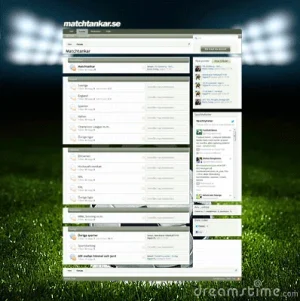

Oh sorry, it looks like that but this is just a Photoshop image Ive made to illustrate what I want. Its a picture of my own forum where Ive used layers: I pasted my forums sceenshot onto a background picture and used the eraser tool to create the spaces (having the background image seen through).
Now, how do I do that in XenForo? I see this XenPorta demo site has it: http://8wayrun.com/
But do I need XenPorta to do this little spacing trick? Im under the impression that XenPorta is a huge addon with lots of features - I only want the separated blocks! :)
