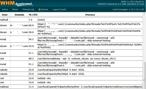

take a a look at my WHM Daily Process Log

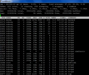

today,once it started to happen i took screen shot of top command
since the server is not using any swap memory then the server dosnt need any ram increase.

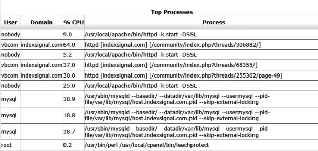

i also checked to top proccwss from WHM
i checked the thread number of 306882 and its only 3 posts thread and its 3 months old, why would it cause 64% of CPU use?

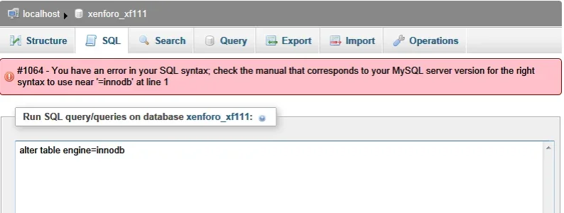

The full command is
alter table tablename engine=innodb
You have to do this per table. Please read http://dev.mysql.com/doc/
converting 132 tables one by one is really too long :(
