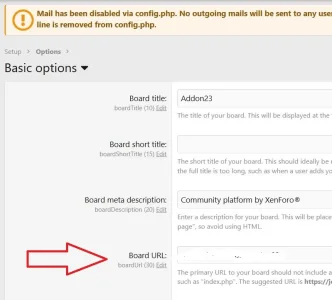

    $config['cookie']['prefix'] = 'test_';
  • Go to the new XF admin and change Board URL
