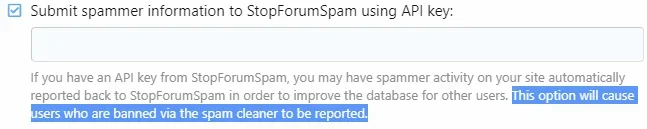

As per the manual link:
Yes but that is only during registration right? If they are not validated I have such option present.
But I can't find any "ban via spam cleaner" option on the forum once a user is already admitted, or I'm not seeing it. Can you point me as to where I can find it?
It's unrelated to registration - it's the spam cleaner.

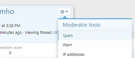

When I check on the post on the little pulldown on the right side, it's not present.

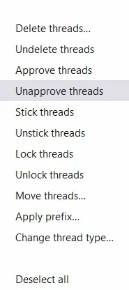

When I tick "select for moderation" in this list I only have this:

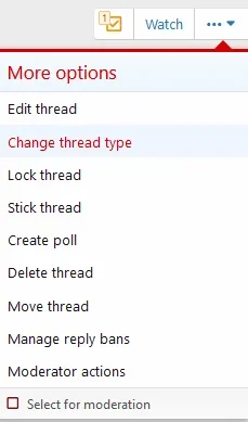

And in the other "Select fo rmoderation" in the post itself it also does not contain the spam cleaner. Tested also in clean default style.

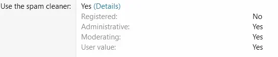

I also used the "Analyse permissions" option and I have permission there too, so I'm a bit confused now.
I checked the Registered usergroup, and it's set to NO, not to Never. But I don't want normal Registered users to be able to use it, so it's no. As far as I understood, an explicit YES (on administrative and moderator groups) will override a normal NO on Registere, correct?
