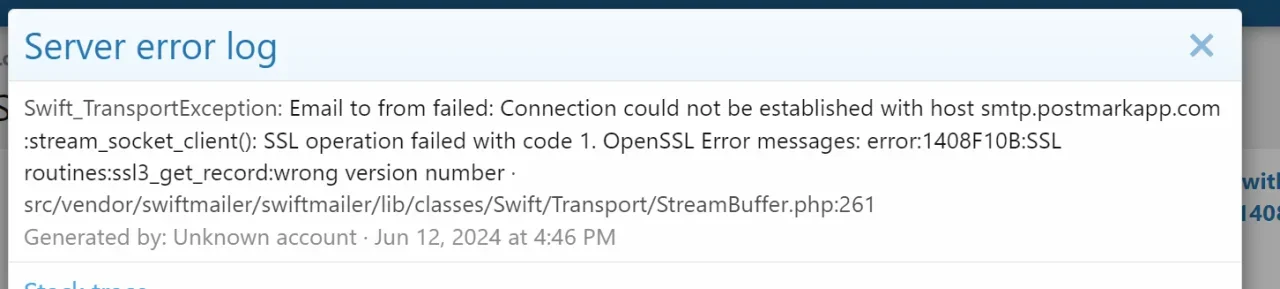

I think there is some bug of the same sort (check my latest post, don't pay attention to the title):
I don't think this has been fixed.
This is the error I'm getting:
Symfony\Component\Mailer\Exception\TransportException: Email to from failed: Connection could not be established with host "ssl://email-smtp.eu-west-1.amazonaws.com:587": stream_socket_client(): SSL operation failed with code 1. OpenSSL Error messages: error:1408F10B:SSL routines:ssl3_get_record:wrong version number src/vendor/symfony/mailer/Transport/Smtp/Stream/SocketStream.php:154

Do you have STARTTLS or SSL/TLS selected in your mail options? And are you using port 465?
If your mail server does not support SSL/TLS (not all do) then you'll want to use an alternative port as that one is typically for SSL/TLS only. In that case you'll very likely want to use port 587 with STARTTLS.

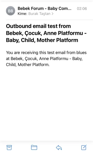

The Baby Community Server is hosted by hetzner. Since Hetzner closed emails as a policy, emails were not going. I preferred the corporate mail system. I recommend namecheap as corporate mail. Also, it is a good thing that mail is banned. If there was no ban, I would have to change the IP of the Baby Community site every 6 months. If you run the mail system on your own server, your site will appear as spam after a while.
