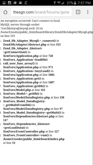

About 15 minutes ago my site appeared to be flooded by bots.
A thread was created last night that gained close to 2k views in an hour. That doesn't usually happen. Another thread that was posted a couple days ago had 14k views. Both threads were tagged with "android".

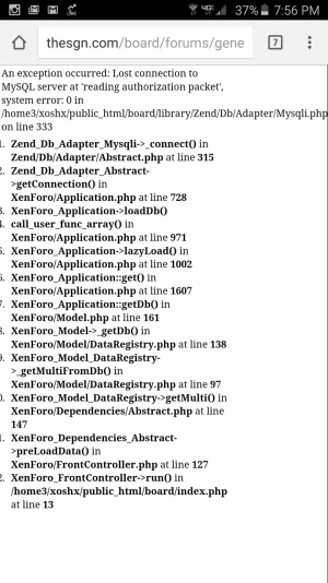

About 15 min ago an error appeared that said "too many connection". I didn't get a screenshot. But I did get a screenshot of the next 2 errors.
These 2 errors are about 1 min apart.
After I removed the threads from public view everything seemed to calm down.
Could this be related to tags? Can bots target tags?
