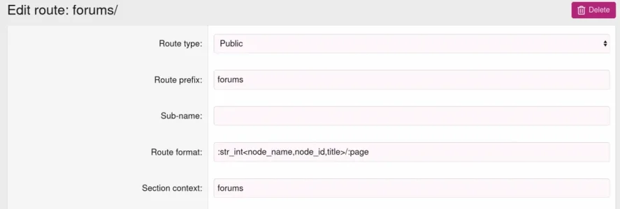

Set the section context in the route to your controller to the corresponding navigation ID.

While that method will work, it's generally reserved for overriding the section context in specific situations. For example, when different controller actions need different section contexts. In general, all that should be necessary is setting the corresponding context entry within the route:
