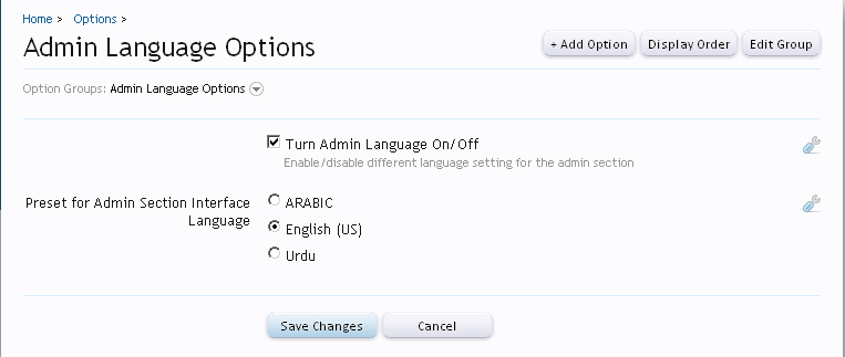

Today I wrote about the situation where some forum admin might like to keep the admin section of the forum in English language although a different language has been set as the default board language. In the post mentioned above I showed a code modification for achieving this effect. Ragtek then pointed out that the same can be done in a better way by making use of a code event. Taking ragtek's hint I have created an add-on which I am providing here. It might come in handy for some of you. Thanks ragtek. :)
Installation:
Unzip the file provided here, upload the contents of the upload folder to your xenforo installation and then import the xml file.
The following screenshot shows the different options for this add-on.
