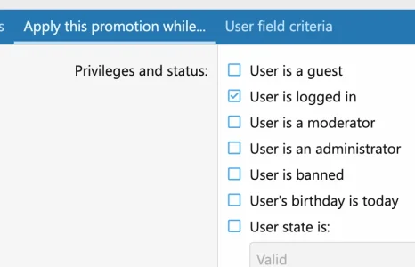

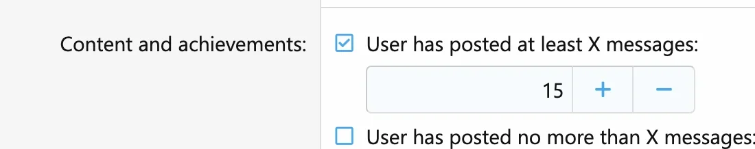

I created a seperate user group called 'Participated', basically exactly the same as my default registered group. I turned off access to a node for the registered group and kept it on for the 'Participated' group. So far easy
My promotion, which moves Registered into Participated does not seem to work though. The only criteria I applied is 'must have 15 posts', and of course selected the Participated as the group to promote to. What am I doing wrong?
