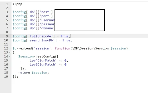

Weird, added that to config.php and still getting the following error. It is running on a reverse proxy.
Oops! We ran into some problems.
This action could not be completed because you are no longer logged in. Please reload the page.
