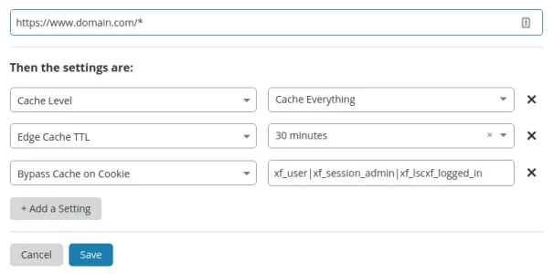

I have it up and running right now.

Oh - business accounts only let you set cache expiration as short as 30 mins. To go shorter you have to either have enterprise or use a custom cloudflare worker which has some marginal

So this new rule cache all+bypas on cookie+ttl 30mnts I should set for *mydomain.com/* ? Right?
And where in my page rules list should I place it? At the very bottom?
