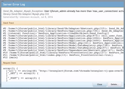

One says "User tjforum_admin has more than 'max_user_connections' active connections"

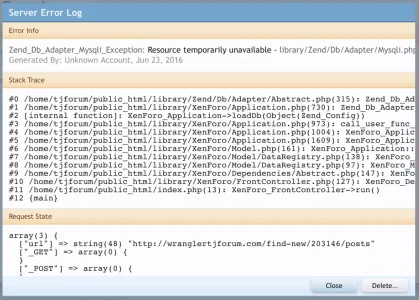

The next one says "Resource temporarily unavailable"

The max connections is a limitation imposed by your host.
It could be that it is particularly low, or it could be due to some sort of DDoS/flooding, or an add-on causing it.
The second error is related to the same issue.

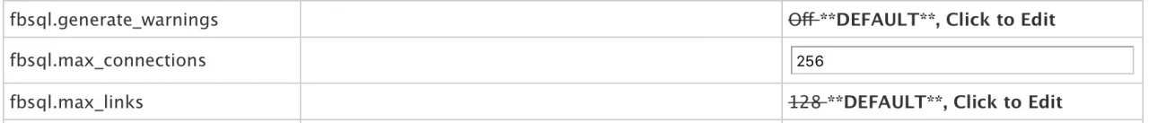

Found it in WHM through the PHP Configuration editor settings. I changed it from 128 to 256. We will see if that fixes the issue.

Not sure.. but if it's a PHP option you changed, it won't effect it. That is a DB error from MySQL telling you that there are more connection attempts than the variable in my.cnf is configured for.
The variable is the max_connections one, and the my.cnf should either be located at /etc/my.cnf or /etc/mysql/my.cnf (typically).
