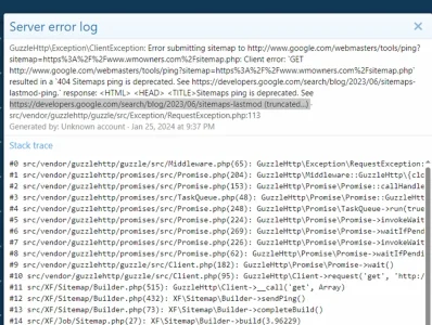

GuzzleHttp\Exception\ClientException: Error submitting sitemap to https://www.bing.com/ping?sitemap=https:///sitemap.php: Client error: GET https://www.bing.com/ping?sitemap=https%3A%2F%2F%2Fsitemap.php resulted in a 410 Gone response
src/vendor/guzzlehttp/guzzle/src/Exception/RequestException.php:113

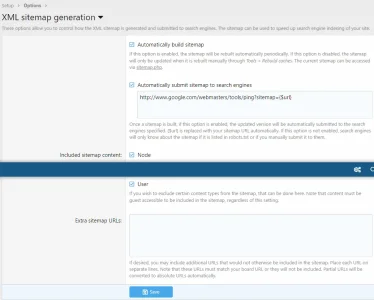

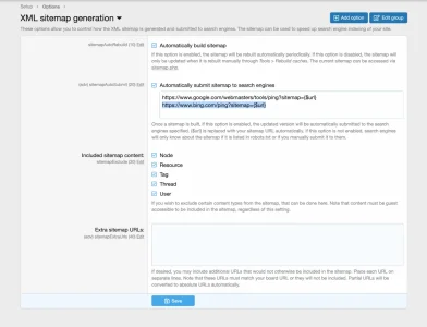

Thank you for the above tip. Although this is an XF2.1 thread, I am using XF 2.2.13 and started having this same server error with Goggle (not Bing) about two weeks ago.
So, I deleted the "Automatically submit sitemap" URL for goggle.com (see below)
@GW2 There are already a couple of threads about this. Google stopped this kind of delivering of sitemaps.
Just disable this function by deselecting it and/or remove the Google link.
