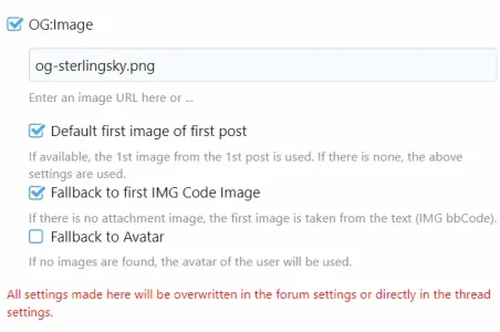

OK. I still have a problem. Posting this because I'm not sure if it's the same issue you're working on.
Using SEO 2.1.0 with these settings:
If the first post of a thread contains an image, that image is posted to Twitter.
If the first post contains no image, it does NOT fall back to the default og:image (og-sterlingsky.png in this case) - it desn't use an image.
Maybe the image should be set with full path, e.g. /styles/og-img/og-sterlingsky.png :unsure:
I have tried different settings for this. Currently, to simplify things, the default og:Image is in the root, so that is the full path.

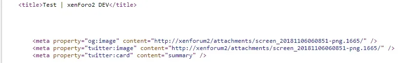

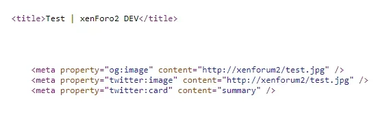

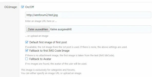

Via the forum options.
Thread without Attachment
Thread with Attachment
Important is:
Since the image is retrieved externally, you must always use the Full URL.
Not (/)styles/image.png but https://domain.tld/styles/image.png
