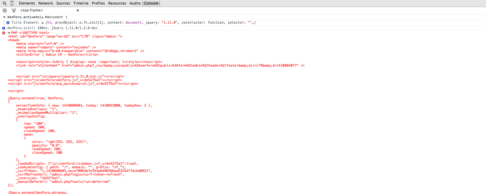

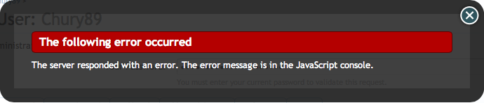

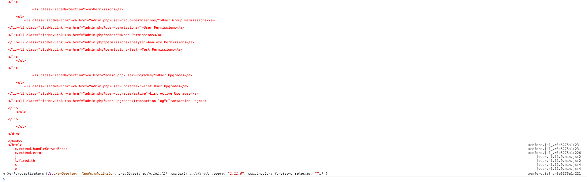

hmmmm maybe this is more interesting?
By the way, no idea if it helps you, but when i change mail info for example it works fine. but changing the basic board or changing user info i get these error's. ( even though i dont even change anything )
It's returning HTML which fits with what I was suggesting about form data not being received by PHP correctly. This could be related to your web server configuration (how PHP is connected, how data is passed to PHP, etc) or it could be down to your PHP configuration (max input vars, max post size, etc). I would probably suggest taking your configuration/setup back to more of a "default", out of the box system and then make changes one by one to identify what's causing the issue.
