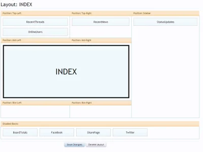

I just installed XenPorta and was playing around, thought I might be able to achieve it with a layout but it seems the layout is restricted even in the index view to having the forum index always be anchored against the left hand side.
Not sure if this is a XenPorta design element or some kind of underlying Xenforo restriction.
Going to try a couple of the other portals now and see if it's any different.
