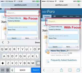

When the search input has focus, it looks like the other inputs.
But when it doesn't in focus, it gets rounded corners. Probably webkit input appearance affect.
Safari iOS7
