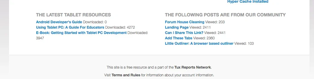

It's working ! :D
Now I need to clean up the general layout for the footer and the WordPress side will have links to the latest resources.
Very cool. Thank you xf_phantom. :notworthy:
