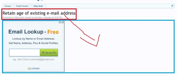

I don't understand why the title is breaking out from the table - {removed link}
I'm trying to move the title & description into the right side of the table

I looked up float and added the EXTRA.css and updated thread_view but the thread title still "breaks out" of the table and appears above it

If I remove or replace the <xen:h1> I end up with two titles on the page, the version you are forcing and the extra version I'm editing.
There must be a way to work with the thread title displayed on thread pages?
I styled this into three groups.
Mobile and "logged in desktop" get your layout, and I'm simply trying to move the thread title displayed for desktop visitors.
How can I get what I marked in red inside the table without it breaking out and/or the forums force duplicating an extra version of it?
