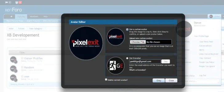

Hi ive made the avatar rounded mostly everywhere but on the avatar upload it looks weird see picture
Anyone knows how can i fix this? Please and thank you

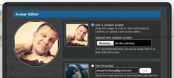

This will get all avatars but it does leave some weirdness in the Avatar Editor after uploading a new avatar that is quite large, wider than higher.
It seems to cover all instances of the avatar though fairly well. :)

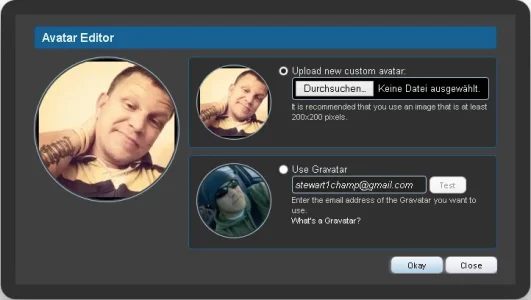

If you want all three avatars in the avatar editor rounded, just put this in extra.css:
#GravatarImg, .avatarCropper, .currentAvatar .avatar img
    border-radius: 100%;
.avatarCropper
    overflow: hidden;

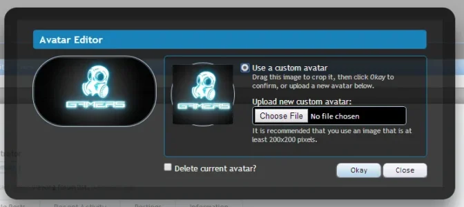

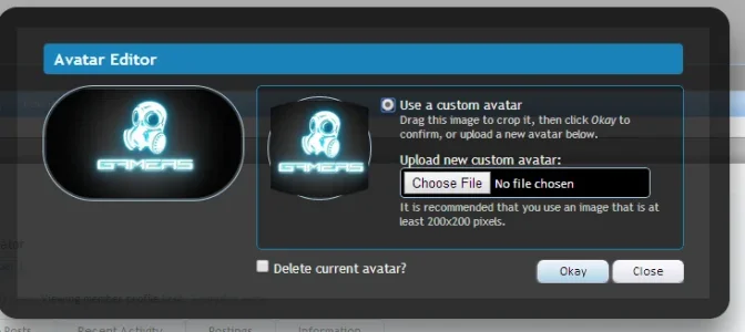

Not rectangular avatars, you'll get an oval. Hence I mentioned to not round certain areas such as the avatar editor.
.AvatarEditor .currentAvatar img {border-radius: 0 !important;}
Right as I mentioned some weirdness but not to awful.

This is a 1016x753 image.

This works great except in the Member list and Profile Followers and people you're following, It's rounded but with the image inside being a square, Any clue how to fix it?
I have achieved this in our community and it always stays perfectly rounded but I had to alter the code of multiple files. Have a look at my signature and get the changes via Inspect element.
The main trick is to round the image container with overflow:hidden and not the image itself. Also, you'll need to lose the unnecessary 2px padding on some places.
