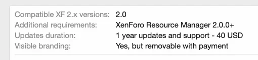

You should uninstall the add-on and install the resource manager first. You can't use an add-on that gives you features for an add-on you didn't have installed. Thats the reason of your issue. It is also mentioned in the description of that add-on.
