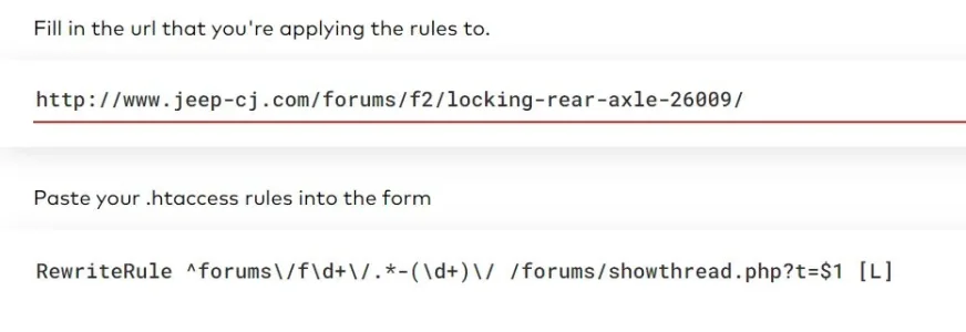

I tied both
RewriteRule ^forums\/f\d+\/.*-(\d+)\/ /forums/showthread.php?t=$1 [R=301,L]
and
RewriteRule ^forums\/f\d+\/.*-(\d+)\/ /forums/showthread.php?t=$1 [L]
so that leads me to believe its my actual expression but I'm not sure?
Does the expression look correct?

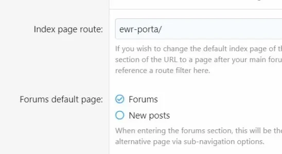

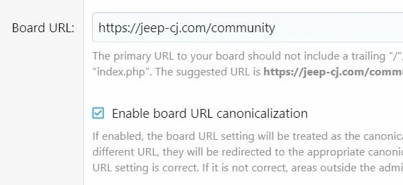

Here are the board settings

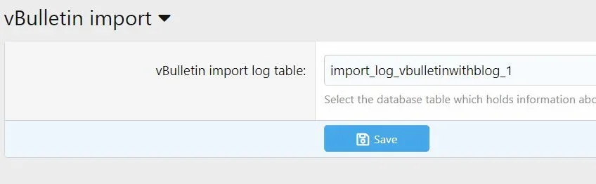

And the import table is

Disabling "Enable board URL canonicalization" has no impact.
Have you tried modifying this to reflect the /community location you appear to have installed in?
Thanks but no go. FYI - I always work in an incognito window when testing to eliminate browser cache issues.
With board URL canonicalization = Enable and or Disable and RewriteBase /community

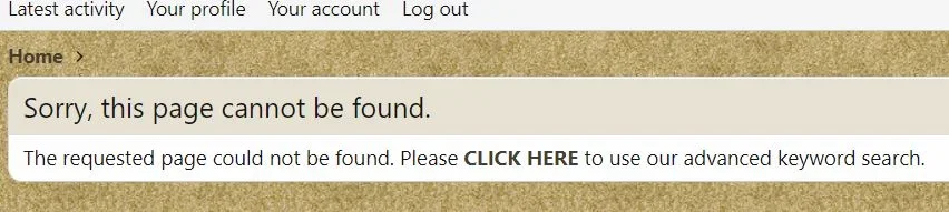

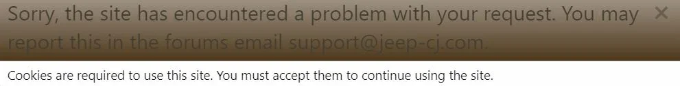

URL http://www.jeep-cj.com/forums/showthread.php?t=26009 gives "Forum not found" and will not acknowledge the cookie.
URL http://www.jeep-cj.com/forums/f2/locking-rear-axle-26009/ gives "Page not found" and will not acknowledge the cookie.

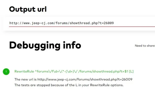

Well I figured out to trace modrewrites in the appache log in httpd.conf, change LogLevel to alert rewrite:trace6 (be aware of your server slow down so just do it temp.)
Here is the trace for the rewrite. I haven't found where it fail.

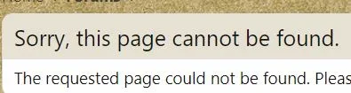

If I input http://www.jeep-cj.com/forums/f2/locking-rear-axle-26009/ = Page not found
If I input http://www.jeep-cj.com/forums/showthread.php?t=26009 it successfully redirects to url [URL]https://jeep-cj.com/community/threads/locking-rear-axle.56727/[/URL]

Rewrite should be RewriteRule /forums\/f\d+\/.*-(\d+)\/ /forums/showthread.php?t=$1 [R=301,L] NOT RewriteRule ^forums\/f\d+\/.*-(\d+)\/ /forums/showthread.php?t=$1 [R=301,L]
I had to drop the ^ I hope this helps someone if they ever have the same problem.

You shouldn't need the R=301 part - that will cause an extra un-necessary redirect.
XF should internally rewrite this for you.
Thanks, your rewrite works also BUT - BOTH only work when clicking a link within the forum. Opening a new window results in Page not found and results in [URL]https://jeep-cj.com/community/f2/locking-rear-axle-26009/[/URL]
Still working on this. Can I get some guidance on this URL rewrite?
Original URL = http://www.jeep-cj.com/forums/f2/locking-rear-axle-26009/#post10258
Rewrite = RewriteRule ^forums\/f\d+\/.*-(\d+)\/ /forums/showpost.php?t=$2
Output URL = http://www.jeep-cj.com/forums/showpost.php?t=#post10258
Need URL = http://www.jeep-cj.com/forums/showpost.php?t=10258
I need to remove '#post' from the output URL.
Thanks for any Ideas.
