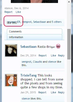

imthebest
It becomes worst when your usernames are large like this:
ThisIsLargeUsername, someonewholoves, MrGoodForNothingMore and 17 others like this.

I was able to reproduce the problem (although not on that media here at xenforo.com but on my forum with large usernames) with my Galaxy Note 3 using Chrome 41.0.2272.96
There is a line-height set on the .mediaLikes .likesSummary, don't see a real reason for it right off and removing seems to fix it.

I have changed
and
.albumLikes .likesSummary
to inherit the @messageLikesSummary style property with an additional "clear" as this prevents problems with the floating nature of some of the elements. Hopefully using that style property will make some styling easier/more consistent out of the box.
Similar change on the .commentLikes summary too.
