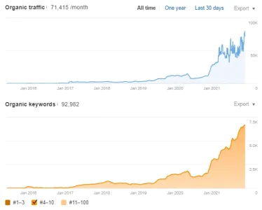

Before I start I want to note that I have considerable SEO experience and just to prove it, here's my main site:
I started focusing entirely on SEO in December 2019 and was able to grow my site quite a bit, enabling me to work on my site as a full time job now.
