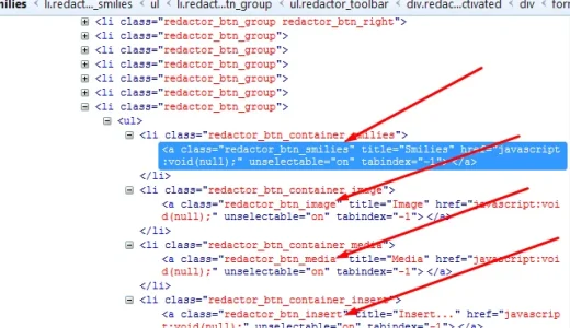

Sorry to be daft, but how do you find the id name of a custom bbcode and do you need to have an image icon there first?

To find any new code, just inspect the code and expand until you can view the actual link and look for the class name there, then replace it like above. Arrows point to the class names:
