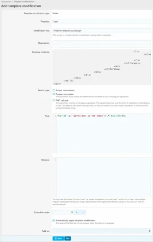

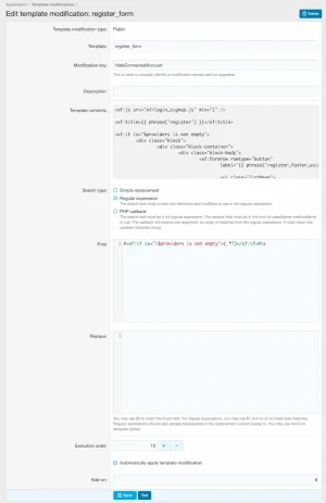

is there a way to remove the ability for users to register and log in using connected accounts? but without actually just removing those providers in ACP?
namely: i would like for users to be able to connect their accounts to all the registered providers but only after they have successfully registered/logged in using the standard method (username/email)
