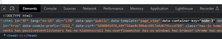

Change the x to the page node ID - use the browser inspector to check that and the classes.
Solution
@Brogan awesome mate! It looks like its working perfectly... just that one page's navi is gone. Thank you!
