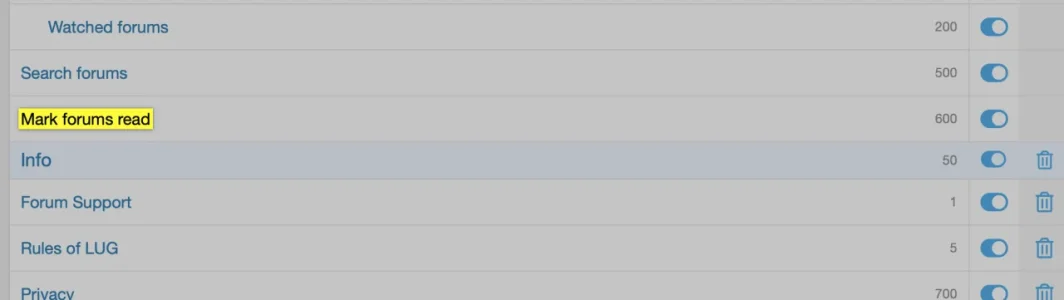

Obviously (as you are probably aware) you should alsodisnable it in the Navigation
Yeah, seems this 'Mark forums read' dealie doesn't appear to exist on my end.Yes
Admin Control Panel > Setup> Public Navigation > Mark forums read
Disable that item via the button on the right
Presumably you did that then as it would have been there by default when you first install xenForoYeah, seems this 'Mark forums read' dealie doesn't appear to exist on my end.
Everything in the navigation is already disabled as well.
Omg yes, you're absolutely right too. Sorry, Mr Lucky, my mistake.Presumably you did that then as it would have been there by default when you first install xenForo
