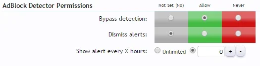

But that subgroup is set to "Bypass", so they should never see the notice at all, right?
"ByPass" is not available in the user group permission settings.
In practice you simply can set all usergroups to never see the notice or to always see the notice or to have a single value for all groups.
If you wish any finer grained permissions you have to leave out "0" and "Unlimited" (do not use them in any user group) because of the bug. You always will get in trouble with them as it is coded now. You are limited to a very high value (instead of "0") or to "1" (instead of "Unlimited") which will not give you exactly what you want, but allows you to fine grain your permissions. I recommend to set your "Subscribing Members" to "1000000" instead of "0" which will work and show them a notice every year. Bad solution, I know. ;)
I see it in mine. These are my settings for subscribers (premium):
As far as I can tell, this is working on my sites.
Ah, you mean "Bypass Detection". Yes, this is also a solution. They won't get any notice no matter what you set in "Show alerts". You just have to be careful not to give this user group to anyone you want to see the notices.

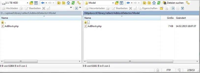

It looks like the file is missing. Go to /library/rellect/AdblockDetector/Model/ and make sure that there's a file named AdBlock.php
No - this file is already there:
left = PC
right = Server
I have all files overwriten with the new one. But I have this error just one time... so, I think it would be a good idea to look at a later time for similar new errors. :)
