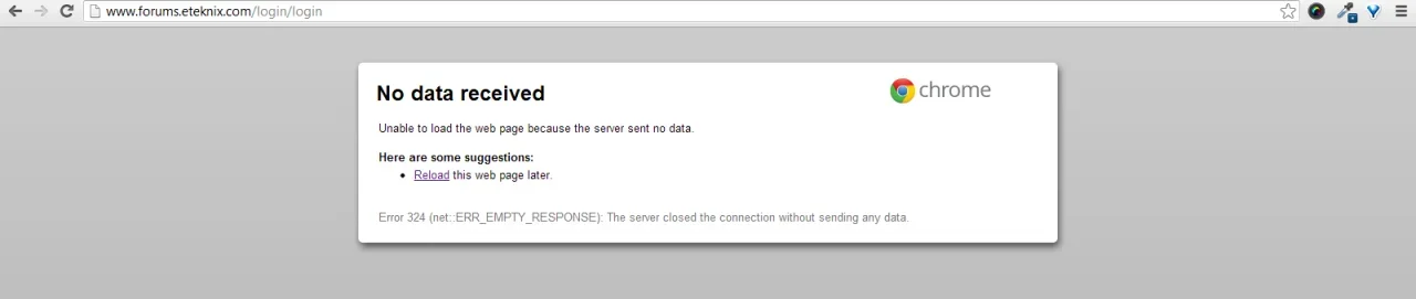

Our forum at http://forums.eteknix.com/ is showing an error when you try to register in all browsers.
To replicate, please go to sign up and when you press through to the next step, you will get a blank page with an error.
The error is "Error 324 (net::ERR_EMPTY_RESPONSE): The server closed the connection without sending any data."

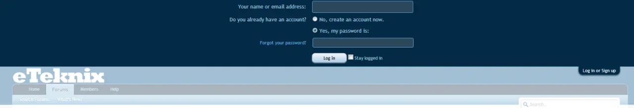

I find I can get it to work if I go direct to the login page, but if I try by clicking "log in or register" and then selecting Create New Account and clicking Sign Up.. I then get the error.

No data received.
Can not display the webpage because the server sent no data.
Here are some suggestions:
Refresh this web page later.
Error 324 (net :: ERR_EMPTY_RESPONSE): The server closed the connection without sending any data.
