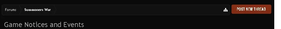

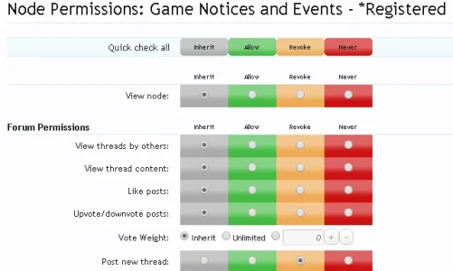

If you see the attachment you can see registered usergroup cannot create a new thread in the forum as seen at the top of the image. This has worked perfectly fine but since updating to 1.4.8 a user managed to bypass the 'revoke' permission and make a thread.
I confirmed the user is not in another usergroup other than the default one 'Registered' and as you can see, the user permission is set to revoke which worked fine until we updated to 1.4.8.

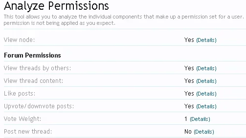

Can you run the permissions analyser on the member to double check the results for that node?

Definitely cannot post on that, this is the result on that specific node.
It worked fine until I updated to 1.4.8 and no other add-ons have been installed (the [AD] Core/Shop issues I posted earlier were on a test forum).

As per the screenshot there is a 'New Thread' icon to the top right on my Admin account and on a new user there is not so I am unsure how he has bypassed this?
