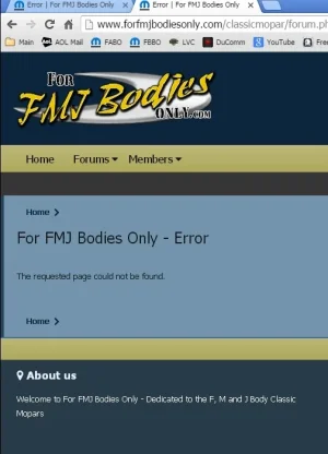

I don't think those redirection scripts actually include forum.php hence there is nothing there to redirect. The author of those may be able to answer why.
That said, I think you would just need to handle this with a line or two in a .htaccess file, in your web root:

eh, didn't work Chris

As it's in your XF directory, you can probably just add something like this to the XF .htaccess:
RewriteRule ^forum.php /classicmopar/ [R=301,L]
Put that line below </IfModule> int he htaccess file in your forum folder
I did. Ill do it again right now.
Edit -- done. Here is the htaccess

Honestly I'm pretty sure one of the above should have worked so there may be some other factor at play.
This will work though.
Create a file named forum.php and upload it to the relevant location. That file should contain:
PHP:
<?php
header('HTTP/1.1 301 Moved Permanently');
header('Location: http://www.forfmjbodiesonly.com/classicmopar');
exit;
