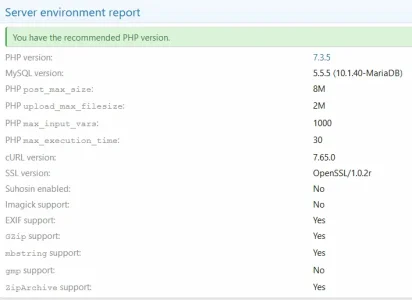

Recommended changes / updates here?
You could get MariaDB up to 10.3. Outside of that everything looks fine.

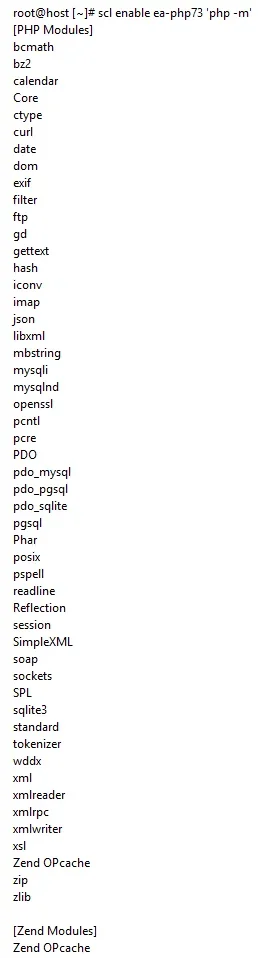

Is Zend Opcache present? Are you using Memcache or Redis for XF caching?

I would install gmp support so you could have Push Notifications for your users. And as mentioned, MariaDB 10.3 as well (unless you're running something outside of XenForo that might have issues)

So I decided to try out Memcached and had the server techs enable it... but when I add the following code to our config.php file, we get nothing but a blank white page on the site:
$config['cache']['enabled'] = true;
$config['cache']['provider'] = 'Memcached';
$config['cache']['config'] = [
    'server' => '127.0.0.1'
Try enabling debug mode to see if there's any errors.
I enabled debug in the config file, but no errors logged.
Maybe we can try Redis and see what happens.
