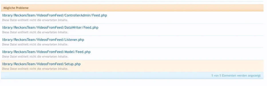

i have uploadet the files 2 0r 3 .. always the same problem under file health check al files have chmod 777

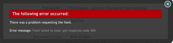

and how can i find the rss feed in youtube ?

I've updated the resource on my forum with new file health check, the issue was my add-on packer. Thanks
