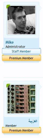

It's not actually RTL-specific. It happens in any situation where the opposite text direction gets mixed in. This is how Firefox renders without the fix:
I think it's probably best that you add code to handle this for your needs. The easiest thing would be to add center alignment to ".messageUserBlock a.username" directly. Alternatively, you can add "inherit" alignment, provided you are explicitly setting an alignment on a parent element. (If you don't, it just undoes the fix.)
