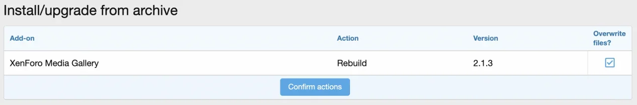

Although we will still continue to do the hash check to determine which files (if any) to copy by default, from XF 2.1.3 we have now added a checkbox on the Install from archive confirmation page to override that behaviour and force all files to be overwritten:
You can only check the checkbox if it is an upgrade or a rebuild. If it is checked, the hashes check is skipped and the files are overwritten.
