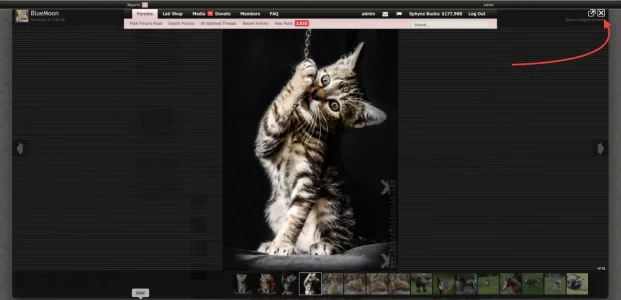

Another abandoned add on?@rainmotorsports - this add on causes the image viewer to NOT be able to "X" out of it or close it.

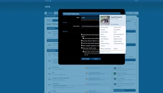

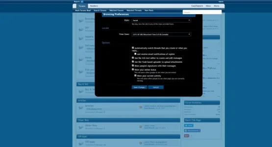

@rainmotorsports When I click the user menu and then click preferences and the preferences pop up, the user menu stays and overlaps that. It is a bug. It doesn't happen when it is disabled.

@rainmotorsports - can you fix this issue o I can continue to use the add on?@rainmotorsports - this add on causes the image viewer to NOT be able to "X" out of it or close it.
This worked- thank you.@CarpCharacin I wanted to give you an update and @tommydamic68 maybe this will address your question about abandonment. I thought I'd have this sinple fix out by now but not even being installed since I made it for someone else I haven't been able to quickly test and release.

Realistically all you should need to do is look in templates for raindd find the CSS template that has the zindexes and change them from 10000 something to say 9998 and below.
I won't throw up a release without testing it though.
position: fixed !important;
z-index: 9999;

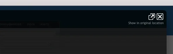

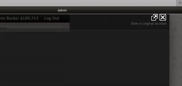

However I just noticed that the rare up by the "X" is running into the navigation bar. There should be a space there. Not sure if its always been like that. As you can see below how it should look.@CarpCharacin I wanted to give you an update and @tommydamic68 maybe this will address your question about abandonment. I thought I'd have this sinple fix out by now but not even being installed since I made it for someone else I haven't been able to quickly test and release.

This seemed to have fixed it.However I just noticed that the rare up by the "X" is running into the navigation bar. There should be a space there. Not sure if its always been like that. As you can see below how it should look.
.xenOverlay.lightBox #LbUpper {
margin-top: 18px;
margin-bottom: -13px;
Lowered Z-Index values both below the xenforo overlay as well as the gallery overlays. Should fix known problems. However if like me you run XenPorta 1 with a slider the z-indexs for the controls in the slider need to be lowered so they don't show ontop of things they shouldnt.
