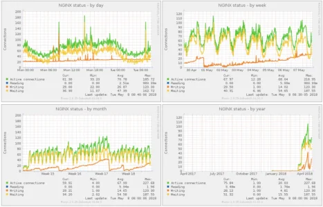

A question for the Nginx experts in here. Is it normal for the Nginx threads that are actively writing to steadily increase? Please see our Munin graphs attached.
Can be normal but can also be nginx bug https://serverfault.com/questions/6...nx-to-accumulate-connections-in-writing-state. Writing = connections writing to client/visitors. So gradual increase in concurrent visitors over time where nginx isn't restarted maybe.

Bug wise, specifically
There is at least one connection leak in HTTP/2 as fixed in nginx 1.11.3, and the fix is not yet available in 1.10.x. Please try 1.11.x instead.
What version of Nginx you using ? I don't see such and use Centmin Mod LEMP with nginx 1.13.12 right now.
Ah that could explain it. We are on 1.10.3 on Ubuntu 16.04LTS at the moment and I will update it to 1.11.x now. Thank you.

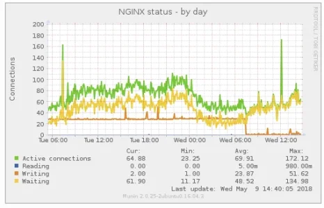

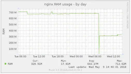

Just to close off this thread. Updating Nginx to 1.11.3 solved the issue for me. Nginx memory usage also dropped by half so bonus!
