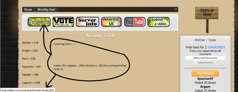

<xen:if is="{$page.node_id} !=282">
    <xen:include template="vote" />
</xen:if>
I would think this would work...just replace 10 with the node id of the page that you would like it NOT to show up on. I changed it to what i think your node id is..
ahhh....um well if you want I can take a look on your admincp, I can probably tell you if I can do it at least...otherwise you are going to have to wait for the creator of the addon. I believe it is a paid addon and I can't use my paypal right now or I would just grab it myself.

did you try this....
IT WORKED!

IT WORKED!
Anyway to remove it from http://kingscrafters.com/index.php?members/ page too :p
replace this code we entered...
HTML:
<xen:if is="{$contentTemplate} != 'merc_goal'">
</xen:if>
with this snippet
HTML:
<xen:if is="!in_array({$contentTemplate}, array('merc_goal', 'member_list'))">
</xen:if>
...lemme know if that works for you
