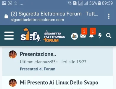

I have noted that after the last XF upgrade, is come out on PWA, the link field up the app, as it is a normal browser. Does someone know how can I remove that?

Yes sure this is a scrrenshot

As you can see, up is appeared the links tab after I have upgraded the last vesion of XF. Before there wasn't.
Exactly. Also to be noted that pressing on the 3 points up on the right, it open a little menu relative to pwa and not the menu as a normal browser, so it should be related to a pwa setting in some where maybe. But I haven't thouched nothing relative that in the last times, I have only upgraded XF to the last version.
We send different manifest contents based on the browser requesting. (As specifically, "standalone" only makes sense on Android, as we rely on the OS-level back button.)
You appear to have it set so your server is caching the results to webmanifest.php -- I can see a Litespeed related cache header in the response. This means that it won't react to the requesting browser as expected.
