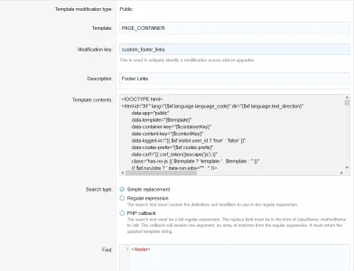

So the best thing to do is to create a template modification:
and in "Replace" you put in your links
e.g.
HTML:
<a href="xxx">xxx</a>

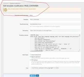

Even if we try to edit an existing (disabled ) template we get this error message. Also, in spite of what it says, none of the fields are editable.

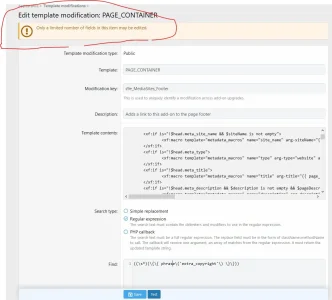

I can't even edit the s9 media plugin template modification to swap out their footer URL for the one I want to use. I am trying everything here.

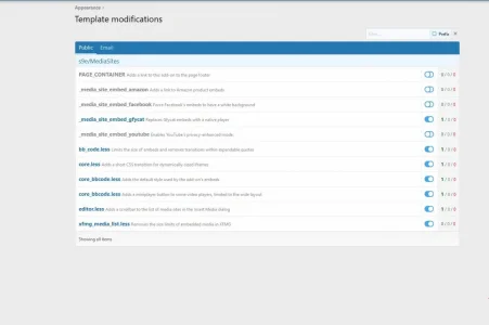

When I click the template modifications link in Admin CP, this is what I see. There is no 'add modification' button. The existing modifications by add-ons are there in the list, but they are uneditable.
How do I create a modification so it shows up in this list?
