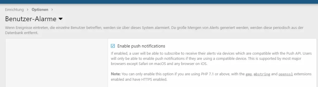

I'm getting desperate. I've been trying to get push notifications working again for months. They worked for a long time. Then suddenly not anymore. I didn't pay any attention to it for a while, but now I'd like to use it again.
I did what I felt was necessary for them to go. But they don't.

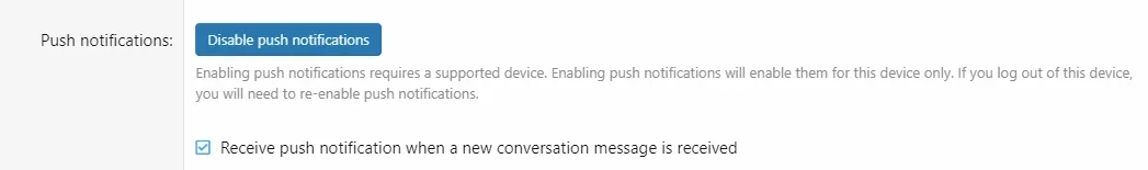

I activated it in the settings, I activated it in the user groups and also in the profile. Furthermore, the server settings are all given.

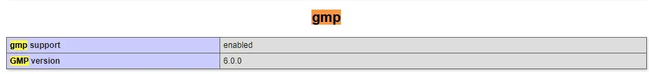

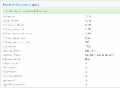

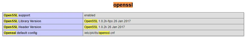

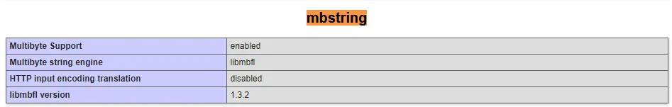

So. I wrote to the support and I also did a PHP evaluation. All necessary modules are activated. So it's not the server and hoster. So I guess I'm correct with my bug report.
